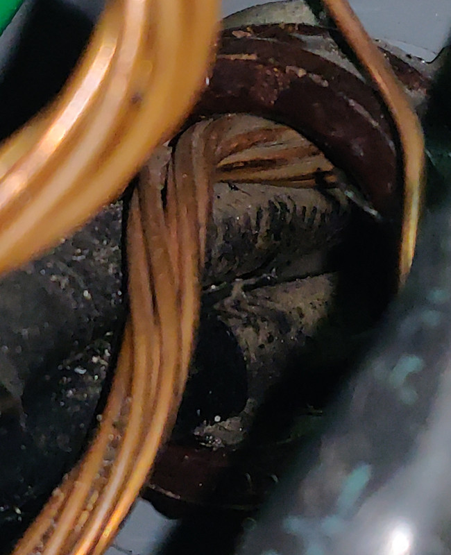

1940s install at grandmas house. Bare copper, two hots, and 240v service. ;)
Probably before NEC, but its working! Back in the 70s there was a QO panel upgrade. Looks weird with no sheathed neutral. Oh well.
If this is showing a service the neutral with the ungrounded service conductors is permitted to be bare.
This is the entrance service panel.
The bare conductor you see in the photo is the neutral from the meter/POCO
Its just weird the panel was updated, and no one pulled a sheathed neutral.
