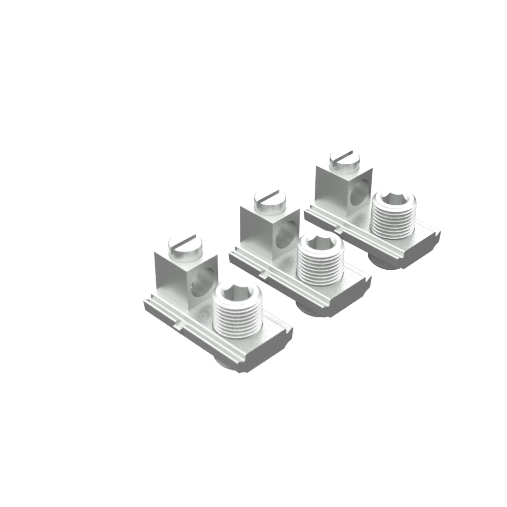

Tapping service entrance conductors.
Appears to be compliant per 230.46, and 230.82(6).
Missed the part about inverter breaker. Verify compliance with 705.11. Usual installation is a fused disconnect, ahead of inverter.
You need to have a disconnect w/OCPD and suitable for use as service equipment within 10 feet of the "tap". From there you go to the invertor. And it would also need a MBJ.
No code violation in the picture that I can see.

I agree that the photo seems to be OK but the OP seems imply that this directly to an inverter which would be an issue.

Don’t forget barriers on service terminals on line side of disconnect. 230.62(C).
