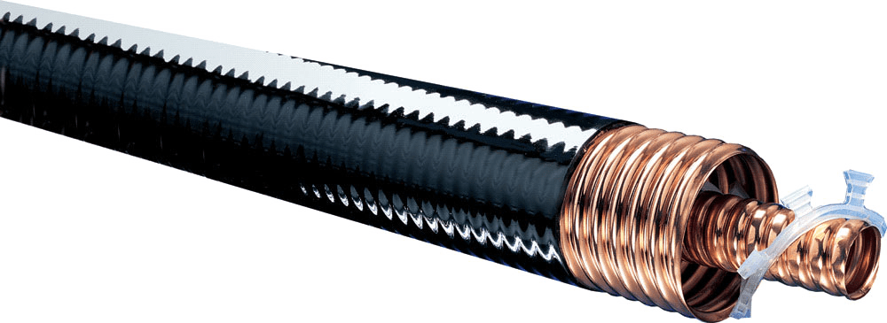

They sometimes have a helical insulator to cut down on losses, and a gas fill -- nitrogen or sulfur hexaflouride -- to maintain dielectric strength.
This type is often used for connecting ratio & television transmitters to their antennas. I don't know whether they're also used for electric power transmission & distribution.
This example is 5 inches in diameter and rated for 12 kV.
When I saw the pic, I thought of the coax lines I've seen used at cell towers we've wired power and grounding for.
At a tour of a TV station years ago, we saw solid copper pipe inside solid copper pipe used as a transmission line.
Us hams call it Hardline

Thats similar to a super conducting cable a few POCOs tried:
