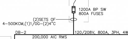

Situation:
Have 800A distribution board feed from service switchgear switch.
The 800A distribution board feeds (4) panels and 2 xfrmrs.
All the loads must remain active with very limited to no downtime.
The 800A distribution board is being replace with new 800A board IN SAME SPOT.
The way I see it the only way to do this with the least amount of downtime is rent generator to feed a temp board and swing loads from existing 800A board to a temp board.
Then install new work and swing loads over from temp board to new board.
Make sense?
