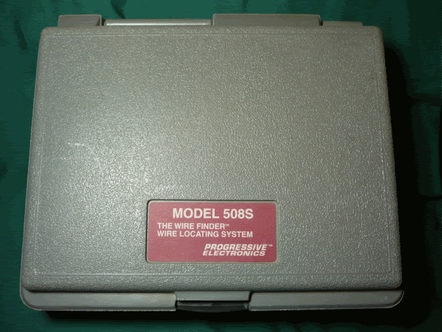

That tool was brought up a while back in a thread. I thought I had one, so I hunted it up, and I do have one. It was in nearly brand new condition. I last used it maybe 15 years ago. I tried it again a few months ago in a home, and I remembered why I put it away back then. It's not very good. I was frustrated with it. The transmitter and the receiver both have dials you need to fuss with, and they're very finicky. You can get it dialed in and find your stuff, it has a good tone, but just fussy in general. Save your money and get an Amprobe AT-2005.

Here's a few close-up pics of the 508s :
Wow!! Now that is good advice you get what you pay for most of the time. I have been beating that drum for a year now. The at-2005 is the best Take some time and learn how to use it. It is worth every penny. I have an older progressive btw it lives in the basement. They all do except for the greenlee which is a good bang for half the bucks.
