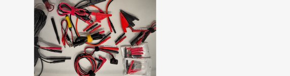

This is some of what's in a pouch clipped to my bag for use with basic T5/T6 testers. There's two pair of pomona brand & then some different amazon brands. I don't think there's much performance difference between them for what I'm using them for. In the bottom right corner are some of the kits.

What is the brand of the two clamps at the top right? Those look Fluke-ish.
Those are Fluke clamps. I feel they're some of the better ones, but frankly I don't like / trust clamps in general.

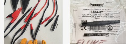

I found a left over Pomona with part #er in a drawer. In the photo u can see that the generic and Pomona both fit, it's just the jacket that differs.

Oh man, that Pomona term is gold! Is all their stuff on their site? I swear they make more stuff than I can find. If I can get the jack ends, I am on a good start! I've hacked most of my silicone leads via soldering the weak strain area and doing double shrink in that area. I now make sure to have gloves on when I test 277/480. Good practice anyway, but.....
I probably have 5 silicone sets with that defect. Can I get that insert out of the jacket?

U can download their 2019-2020 catalog here. I deleted all but about 35 relevant pages of product and saved it. Pomona sells Fluke meters in there too. fwiw I'm just as happy with my generic stuff, though #12 silicone max's it out unless you mod.
