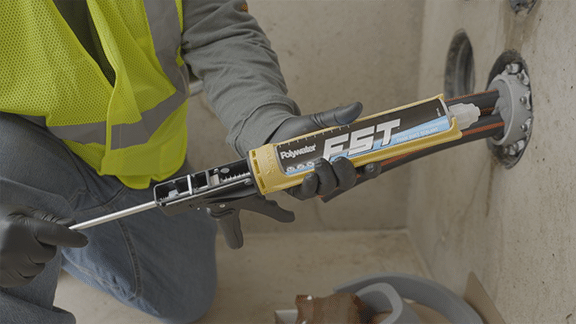

We have cables coming into manhole...600V DC. Is there something that's inexpensive that can be used to test for leaky/stray voltage? Some conduits have 4 cables. Thanks.

We have to fill the conduit with a duct seal type of sealer. It's applied with caulk gun and tube of the sealer. Before we do this we want to check for any stray/leaky voltage. We may do it live.Where exactly are you wanting to test for this voltage? From what point to what point do you think you have "stray" voltage. What is the reason for doing this testing?

Would you apply this to a conduit with live 600v cables?
Polywater® FST™ Foam Duct Sealant | Electrical Sealant
Polywater's FST Foam Duct Sealant has a track record for providing durable and reliable protection in the toughest environments. Find out more and get a quote.www.polywater.com
