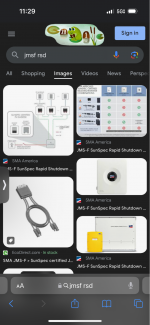

A thermographer colleague of mine sent me some thermal images they had taken of systems that were experiencing frequent failures of their SMA JMS-FSun Spec rapid shutdown devices. He said that many of the failed RSDs were overheated and the heat transfer to the module manifested as hot spots that were visible on an IR scan. So far, so sensible.
What was interesting though is that for the most severely damaged RSDs the IR scan showed a checkerboard pattern on the module (see pictures). He asked me what I thought might be causing this. I told him my best guess is that the failed RSD had somehow cascaded to the PV modules and this was manifesting as some kind of cell level thermal anomaly. Wasn't really sure though about exactly how that might work though, so, thought I would share some of the images here and see if y'all had any thoughts about it.

Those are TIGOs, not the JMS version from SMA. TIGOs are trash and a known fire hazard at this point.
I've seen that thermal signature on modules without MLSD devices so I'm not convinced the two are related.
Also, if it matters, the meta data is still tagged to the thermal images showing the lat/long of the site that was photographed.
My guess:
The signatures might simply be of modules that aren't producing. After all, the sun's energy is still hitting the modules and that's got to go somewhere. Got any unplugged ones to compare to?

My guess:
Yes, To some extent loaded cells will be hotter cooler than open circuited cells with the same insolation since no power is being exported from the cells.
(Unless a loaded cell absorbs rather than reflects more sunlight than an unloaded one?)
Yes, To some extent loaded cells will be hotter than open circuited cells with the same insolation since no power is being exported from the cells.
If "loaded" means "producing electrical power through an external circuit", then I think you mean that the loaded cells will be cooler? This is easily observed with IR cameras.
Cheers, Wayne
image9, and maybe image2, seem to show unloaded modules that are hotter throughout. Images13, 8, 7, and 5 show something more complicated, but I still wonder if they could be unloaded or partially loaded modules, perhaps taken earlier in the day before all the cells heated up, or with the uneven heating due to peculiarities in the manufacturing.
