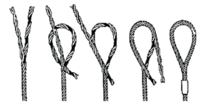

I use these Flemish eyes for all kinds of stuff and not only wire rope.
The swedged on thimble really isn't the strength. The strength is pretty much all in the woven eye. Old timers wrapped the ends with wire or even tape. Way superior to those U bolt clips
