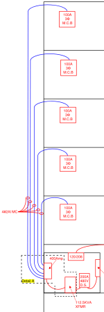

Then you could eliminate the 100 amp disconnects and apply the tap rule to each panel. The taps would have to be larger than the #2 Aluminum risers that they show.Was thinking maybe one 400A feeder then redciue feeder size as you go up as less power would be required.
So might not be miore effecient then what is shown. Anyway we could use the 90 degree column for sizing the AL MC cable?Then you could eliminate the 100 amp disconnects and apply the tap rule to each panel. The taps would have to be larger than the #2 Aluminum risers that they show.
What's the tap rule??Then you could eliminate the 100 amp disconnects and apply the tap rule to each panel. The taps would have to be larger than the #2 Aluminum risers that they show.
No. MC cable is sized at 75°C.So might not be miore effecient then what is shown. Anyway we could use the 90 degree column for sizing the AL MC cable?
240.21What's the tap rule??
Is an OCPD required within 25' of the transformer?If you apply the appropriate tap rules could you not eliminate the 400 amp disconnect ?
(#2 AL is not sufficient for a 100 amp breaker)
Correct. From his drawing it looks like the 400 amp disconnect is providing the secondary OCPD within 25' of the transformer so I'm wondering how that OCPD could be eliminated.Yes.
(and if I understand that rule correctly for >10 fr to 25 ft his conductor would need to be rated around 140 amps.)
Ah I think that I've got it. You would get rid of the 400 amp disconnect and come out of the transformer 4 times, once to each of the 100 amp disconnects.I looked at "detail A" and that looked like the disconnects were real close to the transformer. If the 10ft tap rule won't work my idea is moot
240.21
We don't need to install a 400A disco on the secondary side of xfrm?Ah I think that I've got it. You would get rid of the 400 amp disconnect and come out of the transformer 4 times, once to each of the 100 amp disconnects.
You need an OCPD but I think that Augie was saying if you came out of the transformer 4X directly to each 100 amp disconnect then you wouldn't need the 400 amp disconnect.We don't need to install a 400A disco on the secondary side of xfrm?
Well that would make more sense for use if allowed by code. We are coming out of the disco 4x's so why not just come out of xfrmr? How do I determine fo that is allowed( not using 400A disco)?You need an OCPD but I think that Augie was saying if you came out of the transformer 4X directly to each 100 amp disconnect then you wouldn't need the 400 amp disconnect.
Sorry....so your saying you would come out of xfrmr 4x's to each 100A disconnect and they run to each 100A panel from each disconnect?You need an OCPD but I think that Augie was saying if you came out of the transformer 4X directly to each 100 amp disconnect then you wouldn't need the 400 amp disconnect.
Don't worry I don't understand that either. What does line and load have to do with the secondary conductors of a transformer? You can come out of the 112.5 KVA once to the 400 amp switch which will provide the overcurrent protection. OR as Augie ss saying you can come out 4 individual times, once to each 100 amp disconnect and eliminate the 400 amp altogether.I suggested coming out of secondary side 4x's to each 100A disconnect and I was told it can't happen because line and load need to be fused. Not sure I understand that.
Think they mean disconnects must be fused???Don't worry I don't understand that either. What does line and load have to do with the secondary conductors of a transformer? You can come out of the 112.5 KVA once to the 400 amp switch which will provide the overcurrent protection. OR as Augie ss saying you can come out 4 individual times, once to each 100 amp disconnect and eliminate the 400 amp altogether.
In post #28 Augie has given you the other option.Simple if you come to a 400 amp disconnect > conductors rated at at least 400 amps.
If you go to 4 separate 100 amp disconnects, I don't see a problem with conductors rated 100 amps or greater.
