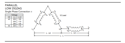

Got a different customer that has special 65kw 480V 3-ph gennys that need to provide 240/120 power. They are moving stuff around and are asking for a quote. When told that at another site they had problems with using just 2-legs of the genny because it would trip on load imbalance. (yep, seen that before). So they had three separate transformers installed and wired together that produce 240/120V and load the genny evenly (or even enough). My first thought was a Scott transformer setup with genuine 2 ph power, using only 2 legs. But no, they have 3 identical 25kw wired up to provide 240/120! Sooo ... we switched to the other genny and I traced the connections, best I could. (There were some phase tape errors ...)
Came home, drew it out from the sketches I made, compared to pics, and realized there must be a black jumper separate from the black output wire. (Arrrgghh!) But which one? This looks familiar to a 12 wire 3-ph genny configured for single phase. Z something, Ill have a look see on the big G.
So does my attached drawing look right? And btw, how does this work ???
EDIT: And can this be done with a single poly-transformer instead of 3 separate ones?
