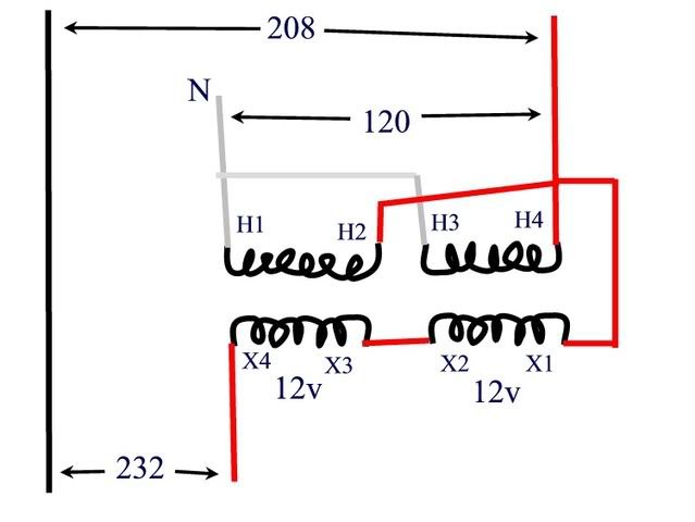

Here is the answer from the contest. I have an issue with it. They are using the 120 volt phase to neutral to put 120 on the BB xfmr, giving 12 v at each secondary. Series this gives a 24 volt boost. Then they take that to the other phase conductor and 208 + 24 = 232.
Problem to me is that the 24 volt boost is not in phase with the 208 volt, so they do not add up, they must be added vectorially. And this comes out to less than 230 volts.
