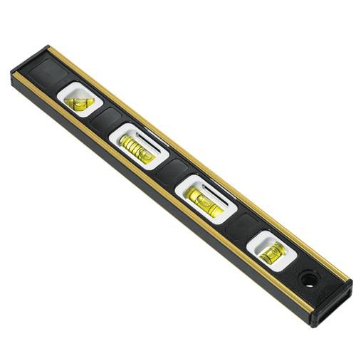

What is the notched out section on the end of the Greenlee used for?
Smart $
Esteemed Member
Ohio
Not the round cut out in the center, the small one on the end that looks like it has a laser lens in it.
Not sure it's there for any certain end-user purpose. What appears in the image as a laser lens is a plug for the hole where the adjacent vial gets inserted. I think it's notched because the vial is wider than the end of the torpedo
