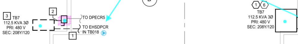

Did you open the disconnect switch? There could be two sets in the single FMC or the existing could be one set.From the pics it does not look like two sets any where as the new feeder schedule calls for.
No. 8 #3/0 could fit in that conduit? Looks like 3 or 4"???? You mean one set of larger conductors?Did you open the disconnect switch? There could be two sets in the single FMC or the existing could be one set.
Yes either two sets in one raceway or one larger set. For 400 amps a single set would need to be 600 Kcmil. You can put 10-#3/0's in a 3" FMC at 40% fill. If the FMC is 24" or less you can put about 15-#3/0's. With two sets in a single raceway you need to be cognizant of derating if more than 24".No. 8 #3/0 could fit in that conduit? Looks like 3 or 4"???? You mean one set of larger conductors?
