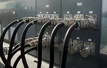

Well i agree its not in the NEC its in the IEEE STD 45-2008 recommended practice for shipboard electric energy & power .
And the US Coast guard will inspect your installation not your local county electrical inspector.
Ship to shore power or what the navy calls cold iron connection http://i611.photobucket.com/albums/tt195/stringking/navycoldironing.jpg
Your hull is your point of ground
PM me if you like ive worked shore power here in florida for disney .
