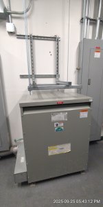

I have attached a photo of a Unistrut support rack that will support a transformer for owner provided equipment. Is this a code violation to mount a transformer over another floor mounted transformer?
I am thinking no if proper ventilation is provided for.

No violation although some thought should be given to providing enough air space for proper cooling. You strut system looks fine with the 4 rods you don't even need the wall attachment. I would raise it up a bit because someone might get all nervous and jerky about the air flow.
Another thought regarding the spacing. I've never seen a transformer enclosure that go so hot that you couldn't touch it with your hand so the amount of heat generated by the floor mount should not significantly impact the hanging transformer.
I on the other hand think you have plenty of space between them. We usually weld steel racks, but rarely put more space than that between them. Stacking transformers is virtually a must in a hospital where you often have 3 or more transformers per electric room
Think how much space is below a transformer when it is mounted on the floor, often just 3" or so. Heat is not primarily disappated through the top of the transformer, the top front and rear vents create a chimney effect for venting.
I believe most manufacturers provide more guidance on front and rear clearances then vertical ones.
Sorry but white paper Eaton not stacking...
It does not say stacking is prohibited. It says ventilation may be an issue and should typically be avoided. You notice they fail to give any verticle clearance restrictions.
Most of the issues revolve around the total ventilation, ambient temp and airflow, of the room the transformers are mounted in. Stacking transformers often occurs when trying to put 10lbs into a five pound bag, so additional air flow is likely needed.
I have seen sloping dividers installed between stacked transformers to redirect the heated air from the lower unit as well as to prevent/reduce the lower transformer from being used as a shelf.
