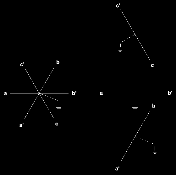

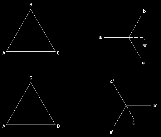

Provided the transformers (or bank of such hereafter) have delta-connected primaries, reverse connect B and C on one of the transformers and the secondary of this transformer will be 60? out-of-phase with the "forward-connected" transformers. Where (') designates secondary terminal on reverse-connected transformer, a' to N-Grd will be 180? out-of-phase with b to N-Grd. The same goes for b' to a, and c' to c.
As to the practicability of this configuration, I make no warrants ;)
I'm impressed. I can honestly admit I never would have thought of that. ----------thinking-----------Nope. Still haven't:)
Smart $, I agree: you would get the necessary 180 degree phase relationships to get 240V...though if anyone got a panel wired (using your notation) a, n, a' (or other similar sets), then they would have 120V line-neutral, and 120V line-line, essentially a corner grounded delta. That would probably cause a bit of head scratching.
Agreed. It would be necessary to wire three 120/240 SDS panels to the respective terminals depicted to the right of the following image. After proper termination, each system would simply have L1, L2, and N... so ungrounded feeder conductors could be labeled, say...
a = 1-L1 and b' = 1-L2
b = 2-L1 and a' = 2-L2
c = 3-L1 and c' = 3-L2​
