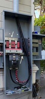

I’m installing a 12 meter EZ Meterpak system with a main 400A fused disconnect, and I’m really trying to figure out if there’s any reason I cannot attach lugs to each bus bar for a Type 1 SPD. Otherwise I have nowhere else to attach it to as each meter only has a space for a 2 pole breaker. I’m attaching a photo of the disconnect with arrows to the buses I’m referring to. I haven’t chosen a SPD yet so any suggestions in that department are also welcome. Thanks guys.

Mount the SPD externally and use one on the existing holes in the bus. I doubt the utility will allow you to install a 30A fused disconnect without a meter.
