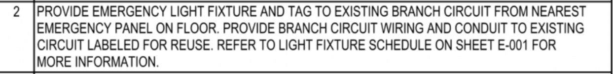

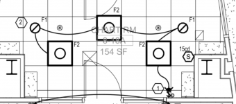

If this one F1 fixture is to be an EM per the note #2 is that possible ot have the others on a seprate normal circuit and the one F1 on EM circuit? They show them wired together. 1706893313946.png 1706893433955.png
700.10
(B) Wiring. Wiring of two or more emergency circuits
supplied from the same source shall be permitted in the
same raceway, cable, box, or cabinet. Wiring from an emergency
source or emergency source distribution overcurrent
protection to emergency loads shall be kept entirely independent
of all other wiring and equipment, unless otherwise
permitted in 700.10(B) (1) through (5):
We have normal lighting and EM lighting. No battery packs. They are fed from a normal panel and EM panel. Separate raceways.
