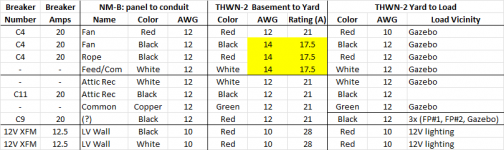

Traced all wiring back thru breaker, and then out to load, and here's how it all shakes out:
It turns out the three conductors I called out last night appear to be the only conductors in violation, although the jump from AWG-12 with 9 CCC's to AWG-10 with only 2 CCC's in the next tube had me wondering what they were thinking there.
