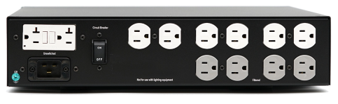

Okie-dokie. The B&K preamp-processor in the pic has been replaced with a Fosgate FAP-T1+, which only has a 12v, 15ma trigger output. The only relay I could find with a coil current that low was a reed relay, which can not withstand the coil current of the 4p contactor. (DAMHIK)
Thus, I cascaded a relay with a coil current the reed relay's contacts could handle, and contacts capable of handling the contactor's coil current. I chose an ice-cube relay with 10a contacts. The two relays are on perf-board in a plastic package, in the panel with the contactor.
So what does the contactor do?
The four switched circuits supply:
1. The 2x 300w amp; left/right front speakers
2. The 5x 200w amp; center/side/rear speakers
3. The two 300w subwoofer amps
4. Various ancillary components
There are two non-switched circuits:
1. The preamp-processor (and relay circuit)
2. The ceiling-hung 8" CRT projector
And two unused circuits; possibly lighting, etc.
I chose the GE 4/8 panel specifically for the offset interior, which allowed space for the contactor.
