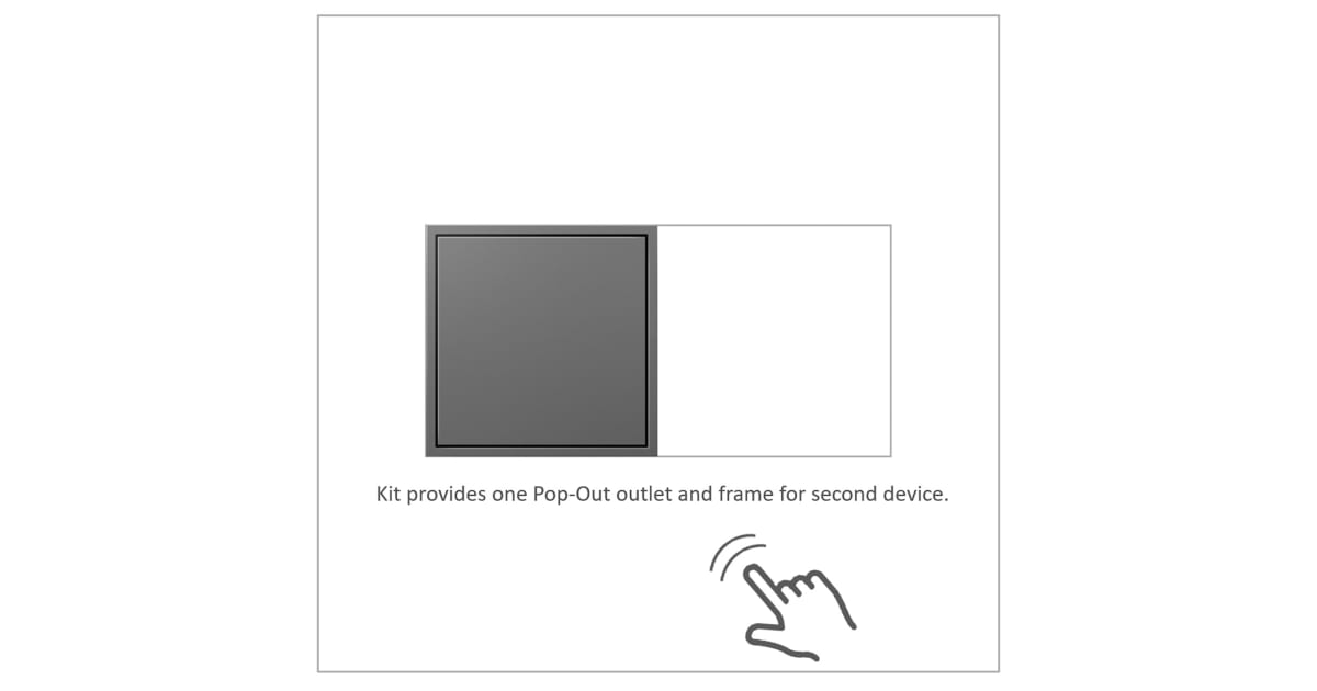

There is also these by Legrande
The adorne pop-out outlet isn’t available with a USB option. Also, just as an FYI, you cannot gang that device unless you specifically order with the 2-gang frame. Not that anyone asked, just mentioning for anyone that sees this and wants to use it.
