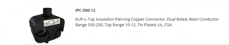

If you meet all the criteria you might be able to find some insulation displacement connectors that you could use to make the tap.

Most lugs are not rated for more than 1 conductor, but you might be able to find some appropriate IDC connectors if it is a single conductor application and not parallel conductors.
