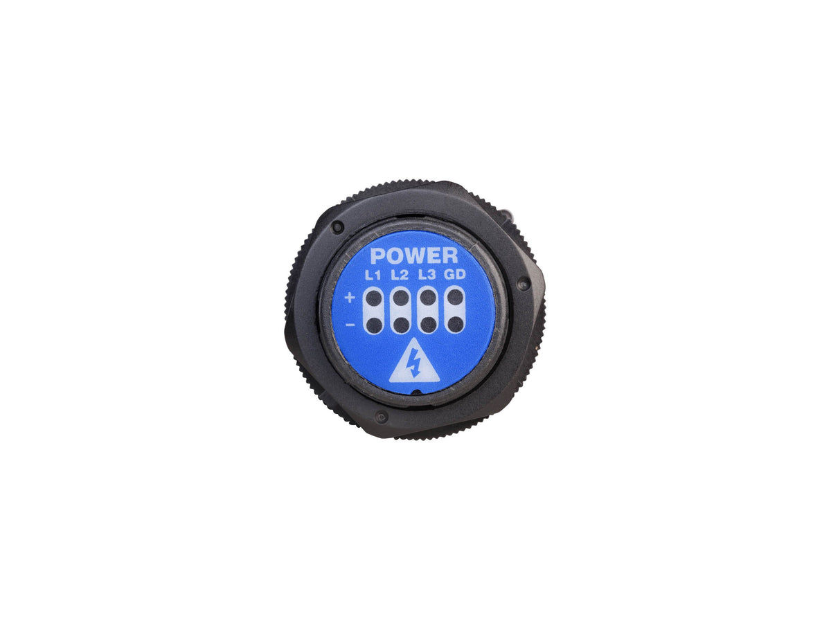

Is there any listed product that can be installed on a (flush mount interior) panel to show when the utility power is hot? Panel is getting an interlocked backfeed breaker for an inlet and they want a way to see when the utility comes back on. I see plenty of commercial installs where they just tap off the main to a fuse block and indicator lights, but I was looking to spec something cleaner for this.
That reliance thing is interesting. Unfortunately the panel is on the wall in a bedroom (stupid Condo architects) not sure if an access cover will fly and I don't think there is room for it within 20" of the main breaker.
