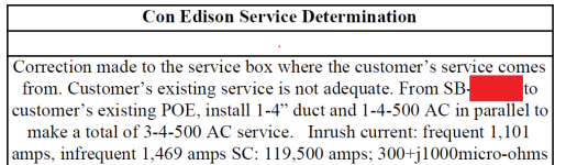

I don't know whether the utility has a breaker before the service end boxMy understanding is it has to do with when the breaker closes and core saturation. Frequent inrush would be the breaker closing at the peak on the sine wave. Infrequent would be it closing on the zero crossing.
The link you showed talks about frequent vs infrequent faults, but this is about inrush currentI had never heard of the term either.
Maybe this will help?
Sounds like a way to plot damage curves.
Is this from a load study of your customer by the POCO ?
Seems like the utility was recording the Inrush current seen *to* the customer for power quality purposes.
If they are running a large single phase load requiring a frequent inrush current above a certain number, the POCO might want capacitors or something installed to cap inrush to a value acceptable for their network, apparently your customers values are acceptable. Problem customers might be metal fab with lots of single phase welders, or a Hospital imaging like MRI or X-rays, that equipment might have a frequent inrush that causes issues for other customers. Just my guess.
You check your main breaker with values by Con Edison for fault interrupting capacity', not trip frequent and infrequent inrush currentsHow it works is I give utility the load and they give us these statements on how they will reinforce the service at their end, so I don't know what they do on the backend. This is a residential and commercial building, not with any complicated loads
What is the calculated load? 1200A?I don't know whether the utility has a breaker before the service end box

Larger than 1200A using the NYC electrical code. Obviously in reality the actual load will be much lower than the conservative values of the NYC electrical codeWhat is the calculated load? 1200A?
They are saying the max fault available is 119500 so I don't think your definition of infrequent is correct.The infrequent is something like a fault on the line, or something like emergency switching or self healing grids. The system may experience 1,469A before protection clears it.
