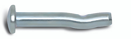

The company I worked for did a lot of prison work in Illinois a number of years ago....from that experience there is no such thing as a vandal proof electrical box.
We had one job were abandoned flush mount boxes in poured concrete walls had to be covered. We installed a 1/8" steel plate with 4 of the above drive in anchors. Before we finished our project, at least 3 of the covers had been removed by the inmates. The tension pull out rating for the anchors, is over 1,000 pounds per anchor.
