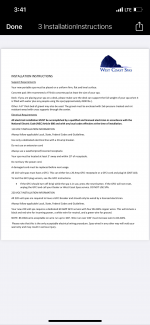

Hot tub I am wiring is saying over 100' upsize wire to next size
Bottom says not following instruction to a tee will void warranty.
My run is 120 feet. Would you think running 20 feet of #4 and splicing and transitioning to #6 for the last 100' is not following there instructions. Trying to save some some money!!!

I am sorry I thought link I posted went to the site, not my email!! I’ll post the manual

I see your point but why would these hot tub people ask for a egc same size as phase conductors. I understand if I ran a NMB it would be impossible to enlarge the egc. Put if I pipe it I have no reason why I can’t.
If they have no controls of the branch side then why do they mention upsizing conductor if over 100’.
I don’t think they have any say with what’s on the line side of there equipment, I just don’t want to deal with them down the road if something happens
