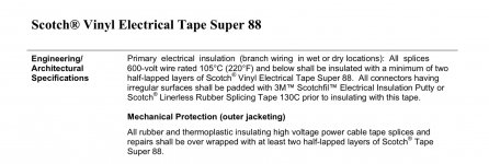

I was always under the impression that all mechanical connections need a rubber insulating tape before the vinyl tape. Because the vinyl tape is not listed for insulation. But that seems to be incorrect. I saw on 3M's website that the regular vinyl tape is rated for 600V.
I assume my understanding was either a myth or one of the things that was passed down from past generation and I never questioned it. Or maybe the rubber tape is required for voltages higher than 600V?
I would appreciate it if you have a UL link as well.
Thank you

So say I have some 600V rated vinyl tape. How many layers do I need? I Cant seem to find that anywhere. Im looking at the spec sheet for super 88, but I cant seem to find any installation instruction though. The spec sheet says rated 600V per UL 510, Standard “Insulating Tape”, Category OANZ, File No. E129200. Will that provide instructions on how to achieve the 600V rating? The stuff is only 8.5 mil thick, I cant believe that one layer is sufficient.....#14 THHN has 15 mil insulation so that is 40 volts/mil.

OH cool, I couldnt find those destructions! So "two half-lapped layers" means essentialy 4 layers of tape? Am I thinking about that correctly? It seems like pretty much any cconnection would have "irregular surface" so I would say rubber tape is required.
So in theory (not that I will do it) but I can wrap my connection with one layer of tape and I should be good to 600V?
