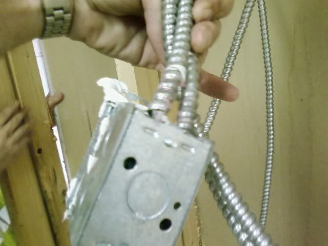

Violation? Case #10212008.

barbeer said:
From the pictures posted, how can you tell if there are not the proper MC style clamps in the box and for that fact that the box size is insufficient?
Do they make a box this size that is at least 16 CI for #14's and 18 CI for #12's, it would have to be at least 3 x 2 x 3 ???
Do they make a box like this that are ?identified for use? to connect MC? I don?t think so. This is a stretch because these cables could be AC and 320.40 is worded slightly different. But either way the cables are falling out of the connections.
tryinghard said:
Do they make a box this size that is at least 16 CI for #14's and 18 CI for #12's, it would have to be at least 3 x 2 x 3 ?”?
Do they make a box like this that are “identified for use” to connect MC? I don’t think so. This is a stretch because these cables could be AC and 320.40 is worded slightly different. But either way the cables are falling out of the connections.
http://tnbelectricalworld.tnb.com/ps/con/selector.cgi?a=next&tpl=sc_sw_mcc !?....................................
Scroll all the way to the bottom!
edit to add "way"
barbeer said:
Not to harp- your math is a little bit off 2x7=14ci and 2.25x7=15.75ci
You might want to re-read 314.16, maybe you missed the clamp? The multiplyer is 8; I'm assuming there's a device?
