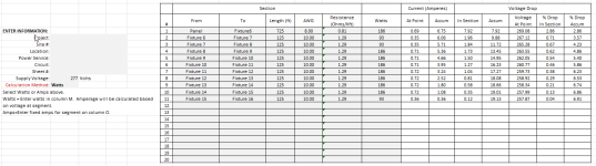

Calculating a 20A 277V pole lighting circuit along the driveway of a large industrial site.
16 fixtures, total of 1,975 foot run. Calculation (see below) gives 6.91% voltage drop at the farthest fixture. Typically, I'd consider this too much, however the fixtures are modern "Universal Voltage" and accept 120-277V. The far fixture would be getting 257V and would be perfectly happy. Aside from violating the "recommendation" in the NEC regarding voltage drop, I don't see a problem. At these distances, upsizing the wire more does not give significant improvement, unless I go to silly sizes ($$$). I'm already at #8 to the first fixture and #10 from there.
The only other real issue I can see would be the effect on clearing time of the breaker, but I don't really know how to quantify that. The total current is only 6.75A, so I could drop the breaker to 15A for faster tripping.
A similar scenario is playing out with the indoor circuits for the 180 high output highbay fixtures.
Thoughts?
P.S., the spreadsheet is an iterative calculation, so it takes into account the increased amperage due to decreasing voltage along the circuit.

If you have a single distant constant power load, and the voltage drop works out to 5% while operating, then the ratio of power lost as I2*R to power delivered is 5%/95% = 5.3%.
For your application, you could easily calculate the I2*R losses in each segment, total those, and compare that to the power delivered to the fixtures. If it's less than 5.3%, that complies with the "spirit" of the 5% voltage drop limit, as least as far as energy conservation goes. [Edit: I get 187W / 19*93W = 10.6% if I didn't make any calculator typos.]

I'm not able to reproduce the numbers in the OP. Treating the fixtures as constant current (based on the power rating and nominal 277V) gives me a total current of 6.37906A. If I then use the currents in each segment to calculate the voltage drop in each segment to updated the voltages at each fixture to recompute the currents, I get a total current of 6.41882A. Repeating the process gives a total current of 6.41900A. Further iterations do not change any of those significant figures. [So convergence seems rapid, and the correction of 40 mA from the constant current approximation seems negligible.]
Edit: the above is using the resistance values per kft in the OP. Those values are slightly higher than the values in the NEC, both Chapter 9 Table 8 and Table 9.
