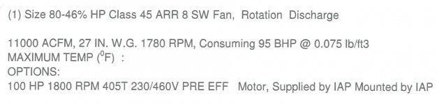

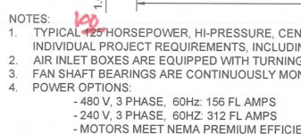

This equipment says 230v. Does that mean a 208v panel would be the same?
Yes, so my quesDo you mean to ask whether it will operate on 208v? The specs only say 230v.
I'd say you need to look at the motor plate or ask the motor manufacturer.
