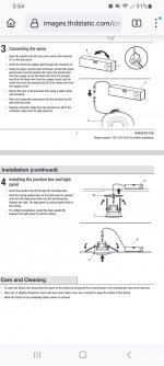

Can wafer lights be used in new construction, ie: open ceilings, without a mounting bracket? So basically turning a new work job into old work and just throwing the j-box up in the ceiling. Second question about wafer lights are they IC rated?
The wafers are designed to be mounted directly the the sheetrock. IMO the box still needs to be mounted to the structure. The Halo ones I use are Type IC and wet location rated.
I agree with Infinity. I seriously doubt that an inspector would get up in an attic or remove one of your lights to see if the junction box is secured or the Romex is stapled within 12" of it, but that comes down to the integrity of the installer. If I were wiring houses today, I would use the wafer lights because of the speed of install, space that they take up on my shelves, and not have to order housings, trims and lamps. I've spent hours trying to lay out 10-12 cans in a kitchen just to have a few hit a truss and throw my whole layout off. IMO, these wafers are the way to go.

Our local AHJ says to mount according to manufacturer instructions for new work. Manufacturer instructions say to mount per NEC.
Does NEC allow for a jb not to be mounted in new construction??
Junction boxes are required to be supported/mounted with a few exceptions for boxes with hubs and RMC. Since these boxes do not meet the exceptions IMO they are required to be mounted. I think that that NEC needs to do a better job of addressing these relatively new products.

Some I have seen that don't have a recommended mounting bracket do not say to mount box in old work only new work. They are listed and this is in the instructions. They use a threaded connector to the junction box so I think that is how they meet the integral junction box like on normal remodel can lights. There is also a style that has the actual box attached to the back of the wafer and is impossible to mount to anything.

What i ended up doing is LOOSELY screwing to a rafter within reach of where the hole will be cut. Let you know how it goes.
That's what I do. With 6" holes it's easy, 4" is more difficult. Here's a 4".
The instructions for those type don't allow for you to screw the box to a joist and the limited hole size would make that an impossible requirement since the junction box would be inaccessible if screwed to a joist at rough.
I just got informed by an inspector on the rough inspection that he is going to enforce that impossible requirement. One of the things my builders like about the wafers is straddling the joists and headers. We have to run EMT here, no romex (Chicago area) but we can use 6' Greenfield whips. We already had one town outlaw FMC for recessed lights, so we went back to cans there. May have to do that in this town as well.
