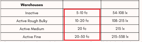

For a warehouse the IESNA recommend footcandle levels are:
Who really knows if it's going to be "inactive", "active medium" etc.
It's a very large warehouse with high pile racks, that's all I know about it.
Curious what footcandles you guys are designing these warehouses to?
I'm on the upper end of that range for the one I'm designing, like 40-50.
Any thoughts?
