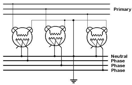

I've noticed that the various poco's in my area use 120/240 volt transformers when they build a 120/208 service, and only use one 120 volt coil from each transformer (center tap and one outside terminal connection). This leaves the other 120 V coil unused. Isn't it needlessly wasteful of electricity to do it this way? (additional power consumed by the coils that sit there and do nothing.) I realize they do this for inventory reasons, and presumably to save money.
I've noticed very few of the straight 120 V transformers used for the 3-ph services, so it is done that way occasionally.
