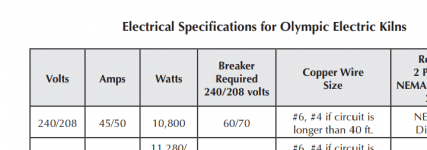

I am trying to wire up two kilns. They are Olympic Electric Kilns (Model 2827H, 11,520 Watts).
I'm trying to follow the manufacturers instructions found here: https://www.olympickilns.com/wp-con...ectric_Kilns_Operating_Manuals_1_revision.pdf
The circuits are over 40 ft, so according to the manufacturer require #4's. I have (4) #4's in a 1'' EMT.
Coming into a pull box, since I'm dealing with #4's and 1'' conduit, I'll need a 8'' minimum length box for a straight pull and a 6'' for an angle pull (assuming no other pulls in the box). Is this correct?
According to the manufacturer, the receptacle and plug can be a NEMA 6-50. For a termination box, I'll need either 2 or 3'' of bending space. What kind of box would allow that? I believe even a 4-11/16'' box would be too small.
Feel like I've opened a can of worms by having to use #4.
