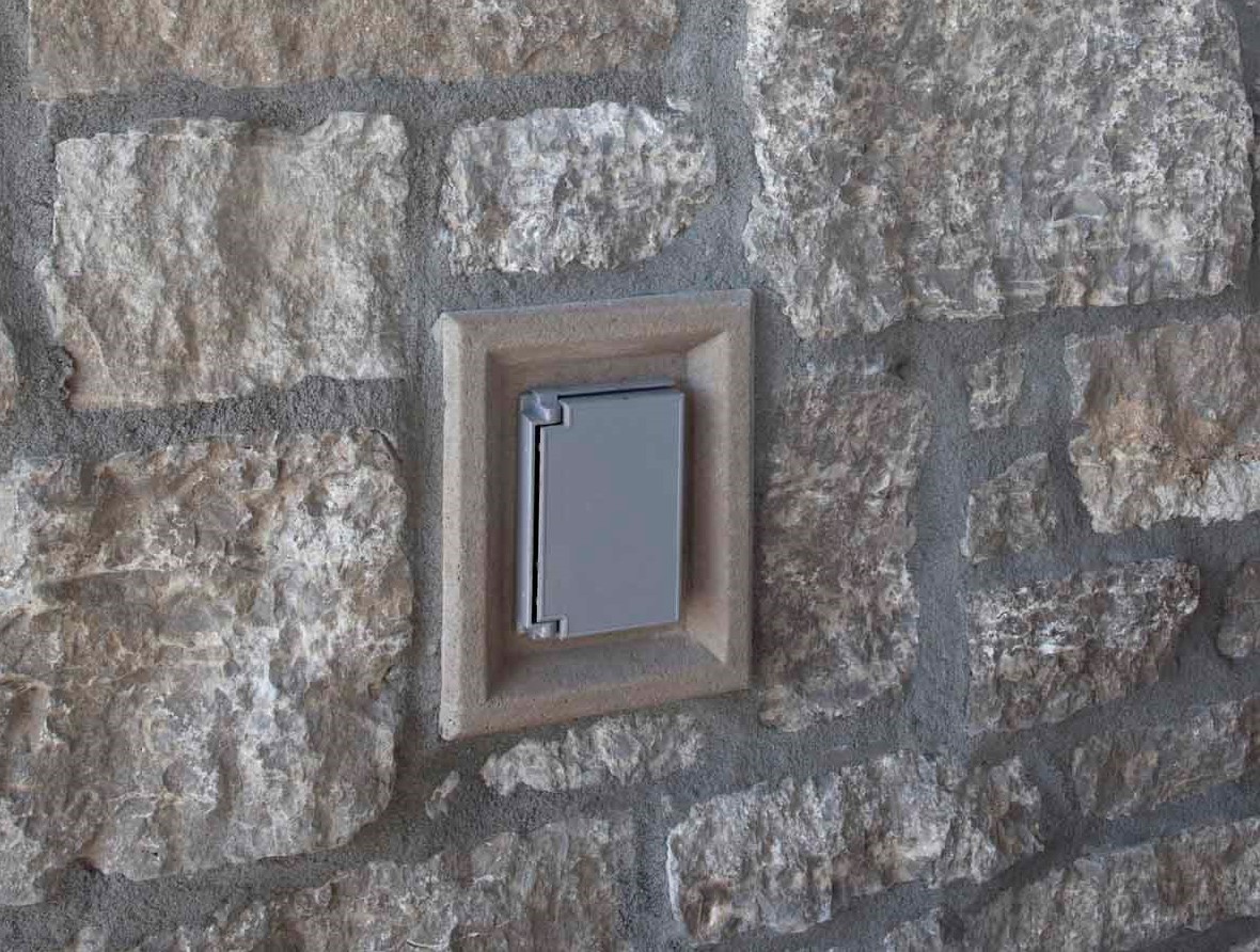

Your choices are surface, partly recessed (box only), or fully recessed, like this:
If it's not real stone, it can be cut relatively easily with diamond cutting tools.
I would price each option (even if cutting is sub'ed out) and discuss them with the customer.
Is this going in before the stone? If so you could use something like one of these. If you're good with a cutting tool these can even be cut in after the stone.
