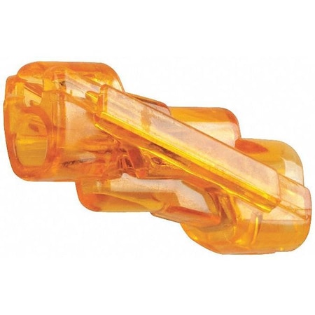

The sheath was torn a small bit of the neutral conductor was damaged. I know what needs to happen, splice it in an accessible junction box or replace it. I’m curious to understand why.
Yes, a splice and a JB are surely the way to go but if you are not able to that without causing a lot of damage you could try a product like one of these in a pinch:
