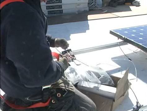

What tool is this electrician using in this picture?
I honestly don't know what it is, which is why I'm asking. It looks like one of those 2-part epoxy caulking guns, but there's no tubes in it, and it looks like he's doing something to a set of wires. I don't think he's got a bum hand. I think he's just got cold hands and gloves with the fingers cut off.

Like Chris said - do you have a way we can get the JPEG. They do have JB's that are specific to Solar - could it be something like that?
That's all I've got. You can hold down the CTRL key and run the mouse wheel up and down to make the picture bigger and smaller.
Never thought I would see the day that I had a tool in my truck that Marc had not even seen before. :grin:
No, it is not a prosthetic limb. :grin:

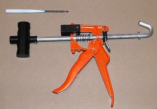

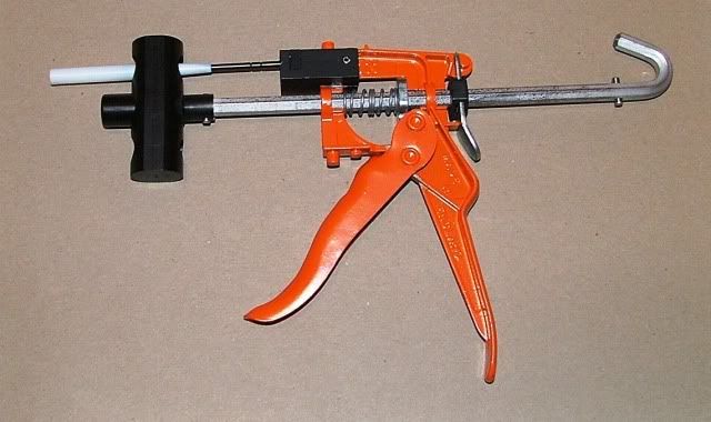

Here are some better shots.
Good luck. :D
chris kennedy said:
Or, whats on his left hand?
He has fingerless gloves on both hands.
The company we work for wants us to have gloves on for safety. Lacerations are a major cause of 'lost time' and workers comp claims.
If the gloves are fingerless, then where are his fingers? How do you know that he doesn't have a prosthetic? I swear that's what it looks like because there is just a nubb where his hand should be, so maybe it's not a prosthetic but just a nubb.
I thought about it, and thought about it. That has to be a spoof picture. Marc's right, that's a two part gun. Where did this pic surface?????
  • It is no spoof.
  • I have that specific tool in my truck
  • The pic came from the job I was working on last week.
  • Reading the whole thread before responding is so old school. :grin:
Bob - nice clip. So what is the tool used for? I think it has to do with the cables coming from the solar panels, and related to tying it in to JBs. Is this the case?
It's made out of a modified caulking gun by the manufacturer, that much is clear. Even with good pictures of it, I still don't have a clue what it is. My best guess comes from a clue in the manufacturer's installation instructions:
"2) SunPower modules can be grounded using third-party grounding washer or clip systems provided they have been tested and certified to meet UL 467 requirements for bonding/grounding systems and are installed according to the manufacturer?s specified instructions"
This might be a tool to install 3rd party grounding clips.
