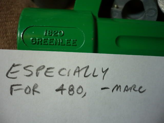

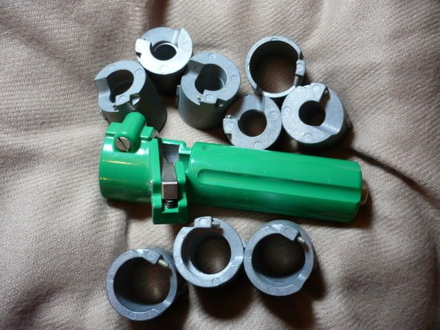

Here's more pics of the Greenlee tool that they don't make anymore:

Hard to explain, but easy to see if you hold the tool in your hand. The 4x4 tool has a blade with each die that has a fixed, calibrated depth. The Greenlee tool has a spring loaded blade that is held at a fixed depth by the collar you put in the end for each type of wire. I don't have my 4x4 tool here at home, but I think I have a picture of it someplace. Let me hunt that up.

As you can tell from its nearly factory new condition, I hardly used it. It worked just fine, but I can skin a wire with a Stanley 99 nearly as fast. I guess that's why Greenlee hasn't sold these in 20 years.
