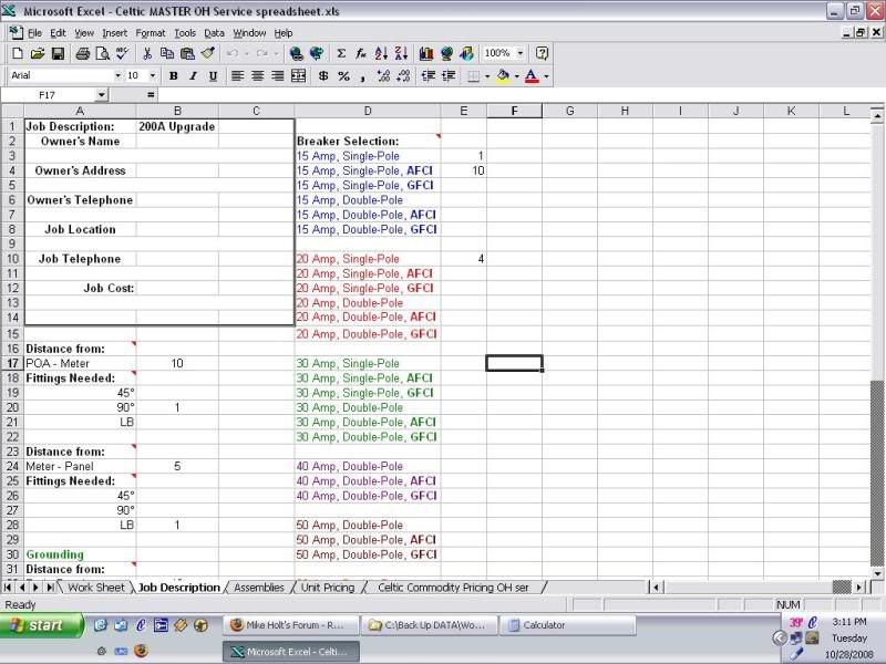

That's the beauty of it! [Supposedly :roll:]
MINIMAL information input....MAXIMUM information output.
Items like couplings, weather heads, duct seal, hubs, ground rods and acorns, lag bolts, etc....forget 'em.
Just tell it:
- how long from Point A to Point B
- any sweeps or LBs
- Length of grounding/bonding
- Type of panel
- Number and type of CBs
That's basically it.
Everything gets calculated based on those few items.

Well....just toss some out and tell me if I am doing it right!
Here is what I got...I entered NO TAX as it wasn't given...I did include 13 CBs, but I used a Eaton panel - NOT 3R, not a meter main:
$2184 w/15 manhours.
How'd I do?
How'd I do?
So....your program calculates the man hours acording to the materials used?
It sounds close. Our low is 2400-2500 up to 5000
Add a couple hours to load and clean out the truck and it's golden. Add lunch money in there too. Got to work straight thru if the place is occupied.
