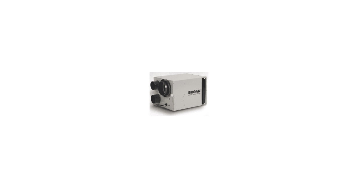

Looking installed a motorized damper to bring outside air into the furnace return air plenum.
The damper would have a timer control and would turn on the furnace fan to bring fresh air into the house.
This type of control must be common in newer homes.
And it seems like there should be an control from the range hood or bath exhaust to open the damper when those are turned on.
The above would be a simpler installation over a air to air heat exchanger.
Any recommendations on timers, dampers, etc. I would have an HVAC company do the install.

Broan has a makeup air kit that works with a pressure switch. But I've seen them with a current sensor installed on the hood circuit. Dumps into return air duct

A word of caution. Most of these systems also have pre-conditioning for fresh air introduction. Had a customer who someone added fresh air ducting into the heating system that had no pre-conditioning, when it got real cold, 10deg to 20 below, (as it does mid winter here) the furnace couldn't keep up and would run without stopping and not really heat. So either your system would need to have pre-conditioning or have a means of temperature sensing that restricts operations below a certain outside temperature. With houses getting tighter, the use of makeup air is becoming more common. A HVAC supplier should have the correct equipment to accomplish this. But likely similar to this:

If the house is so tight that it cannot balance exhausted air by itself, usual mitigations are cracking a window, dedicated OA combustion makeup air vents for the furnace, and a DOAS, dedicated outside air supply / heat recovery ventilator.
For the ducted air, commercially you would see a rooftop unit with an economizer package. The board that controls it is an (outside air) enthalpy control, open the damper to let fresh air in and exhaust air out.
Key in those two scenarios is for the passive venting it responds to demand, furnace running exhaust fan running, with no control needed, and for the DOAS, it responds to outside air conditions, optimized for low humidity moderate temps, and can close off for bad outside air conditions. It's a Honeywell green something board that does that for about $300., the fresh air economizer control. It does not care if the kitchen fan is running. It triggers for good outside air conditions.
I've been running with a window cracked all winter. The step beyond that I would be looking for is a DOAS with the outside air enthalpy control.
If you're going to intentionally bring in outside air, an energy-recovery system should be installed.

Presuming house is very air tight, if you want to bring fresh air in you pretty much need to exhaust same quantity of air somehow or you won't really be bringing much in. Which is what an ERV does
