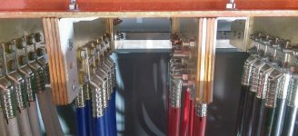

@infinity, that is beautifully done.
What is the purpose of the lines marked on the side of the cable and lug. Was that to align the crimp tool?
Thanks. Typically you'll have the terminal bolted to the bus and then you'll shape, cut, strip, and insert the cable. To keep the orientation of the terminal correct (so that it's not twisted in relation to the bus) we mark both the cable and the terminal. Then the bolts are removed and the terminal and cable end are pulled away from the bus to make room for the crimper head to fit. Then crimp and reinstall.
