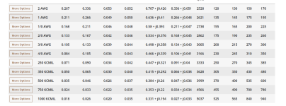

I assume this is a flavor of 310.14(B) (or 315.60(B) for MV)? In any case, my question was more along the lines of wondering why manufacturers don't make 600kcmil MV-105 (or 300kcmil or 400kcmil per infinity's post).
e.g. Southwire:
Sorry, yes you did say that. I wonder what came first the code table or what size are the MV cables that had been traditionally manufactured. In the table you posted there is also 300 and 400 kcmil missing which are both common LV sizes.
True, I didn't see that. I'd imagine the manufacturing tradition came first. Maybe it's just too expensive to make and less granular ampacities are needed at the MV level to make it worth it.
