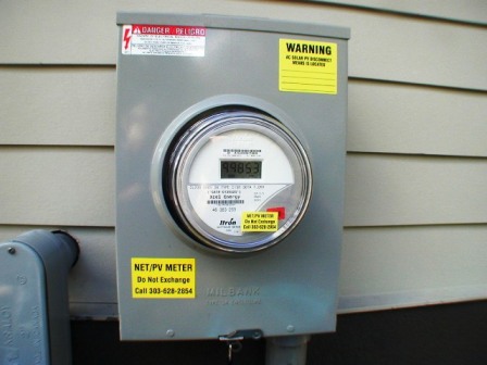

electricalperson said:
how do people with these kinds of systems sell power back to the power company?
Normally with a second meter or a net meter.
It depend on how your state ulitility commission or the like sets the laws.
I hate percentages but a statement has be made here that your selling it back at whole sale not retail to the utility, A I R
but does it actually put electrical energy on the lines?
Um. ... yeah. Why wouldn't it? :-? The PoCo wouldn't buy it if you weren't putting it there.
If you're going to use it all yourself, nobody really cares. If you have extra and want to sell it back (ie, put it on the grid), then you set up a net metering arrangement and get paid for it.

I thought "net metering" meant it comes in and goes out at the same rate.

I am currently installing a "grid interactive" PV system.
From an electricians perspective it is quite simple. I connect the solar array to the inverter and then connect the inverter to the buildings service.
On this job we are using Satcom 50 KW inverter, it is quite a complicated piece of equipment and I will not pretend to know how it works. On the AC side it will be about 150-175 amps at 208 3 phase, on the DC side it will be about 440 volts, 150 amps. (very rough figures based on a maximum sunny day and my recollection)
But as the others have said the inverter matches the grids characteristics before becoming active. If the utility has a power outage the inverter sees that and stops producing power so that it will not potentially hurt the power company workers.
Take a look at Article 690 in the 2008 NEC, there are some nice diagrams of the different kinds of systems.
I am also looking at plans for a 500 KW system that will use 5 inverters in parallel, the DC will be coming in from 6 large arrays (total of about 2,600 panels) be combined and fed into the inverters, the inverter will change that 500 volts DC into 480 volt 3 phase AC.
In both these installations we will be using a 'net meter' and at times these systems will be making more power then the building they are on uses.

Some state commissions are requiring that utilities buy back the power at the retail rate and not wholesale. I think this will catch on eventually and be a rule in more and more states. But many utilities still are buying back on the cheap.:smile:
