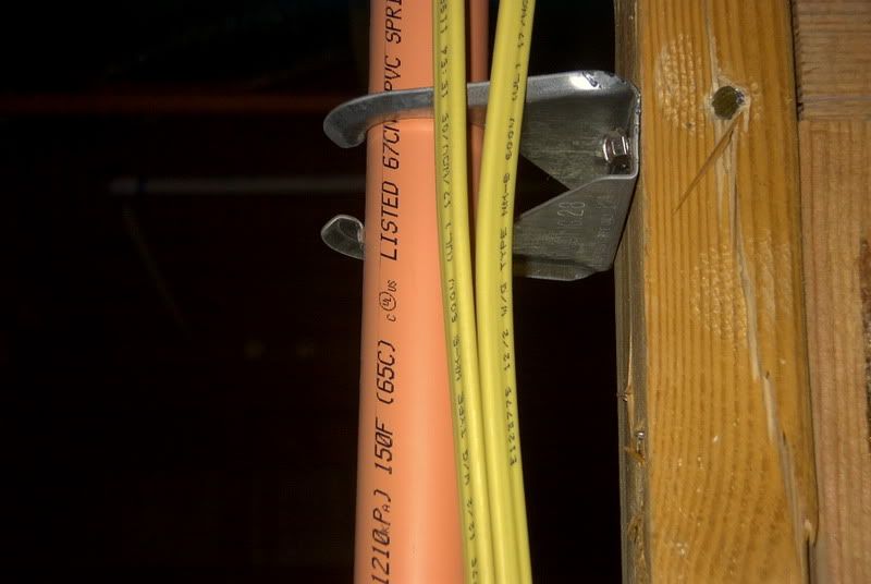

I had to put these in after reading the OP. The fire sprinkler guys came in after we had roughed in the electric. This is not even a small sample of how bad the work they did is.Notice the mounting bracket that puts the NM cable out of the wall.
Nice guy he had to remove the romex staple to do this.
