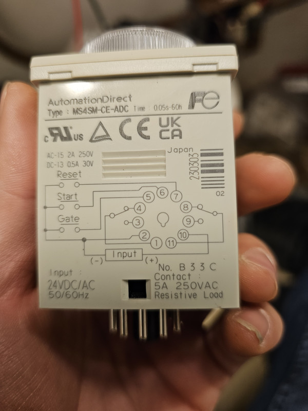

Hook it up like the picture but run your power for your contactor coil for the jets through 11 and 9. ignore the red wires and and the wires going to the lights unless your jet contactor coil actually uses 19v which is a strange voltage to have to be honest.

Save for the fact that it is listed for 15vac.
What is your power supply rated output?
With that relay I believe you would use Time Off Delay. 11 will be your Jet Contactor coil power in (constant voltage of what ever your coil is rated for) 9 will be Jet Contactor coil out. 19v power will go to both of your buttons which should both be normally open contacts. Start will feed back to 6 and stop will feed to 7. 19v hot and neutral will go to 2 and 10.

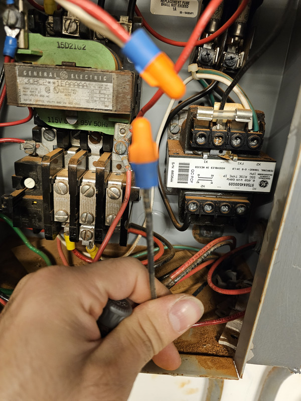

This is the 120v feed in the main shutoff

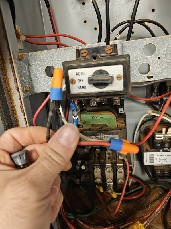

This is the 12v contacter feed

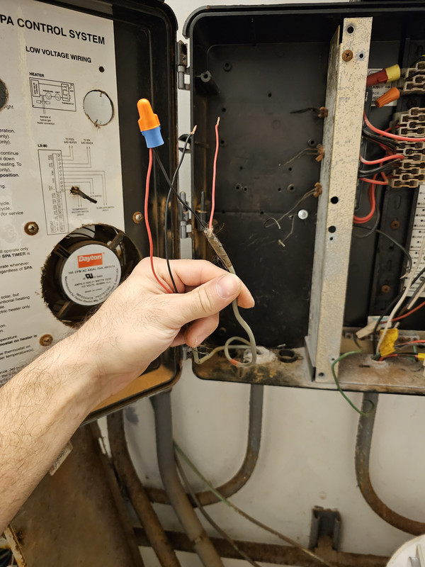

This is the associated return wire for the 12v feed that was just capped off in the shut off
The relay. Black wire capped off in the back is the same as the black wire capped off in the shutoff

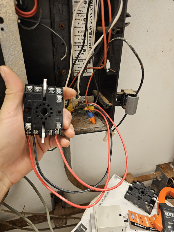

Wires going to the separate start and stop switches. I have the red feeding into stop switch which comes back and splices to the red of the start switch and then comes back to this junction box.
The actual relay

It's hard to tell you how to do this without being there. might help to label each wire and land them on the relay the way I said to then take a clear picture of the relay base and we could see if you got it right from there. I am sure you can figure this out by looking at it as well. Just hook it up in a way that makes sense, there is not much you can do wrong as long as you don't hook up the wrong voltage to the power supply on the relay so just make sure your 120v for your contactor is on on one of the 2 dry contacts and the worst that will happen is the pump will come on at the wrong time.
