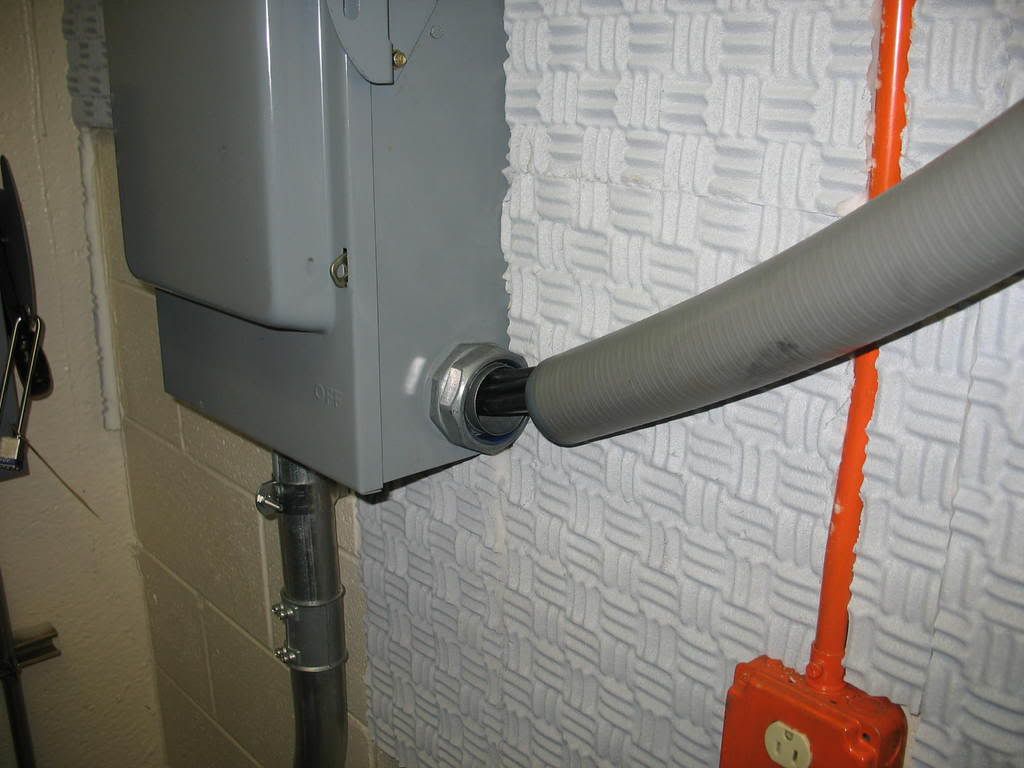

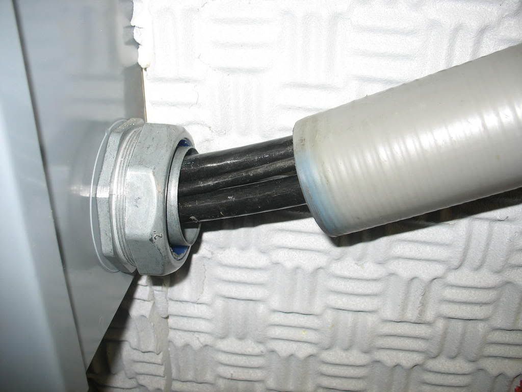

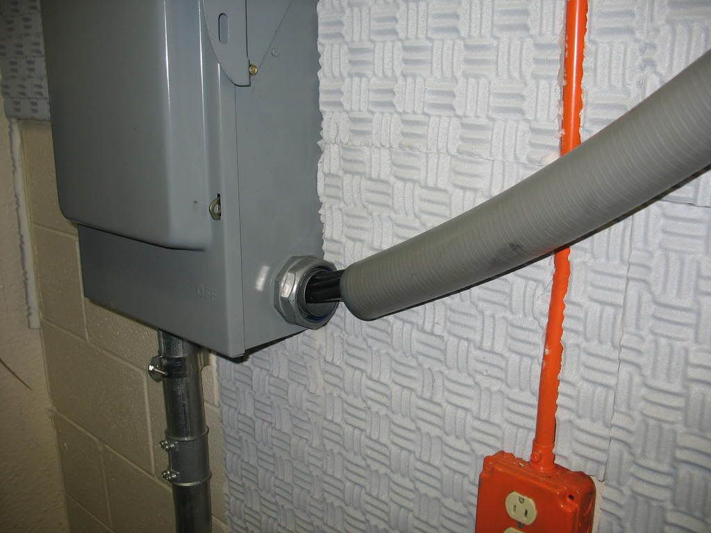

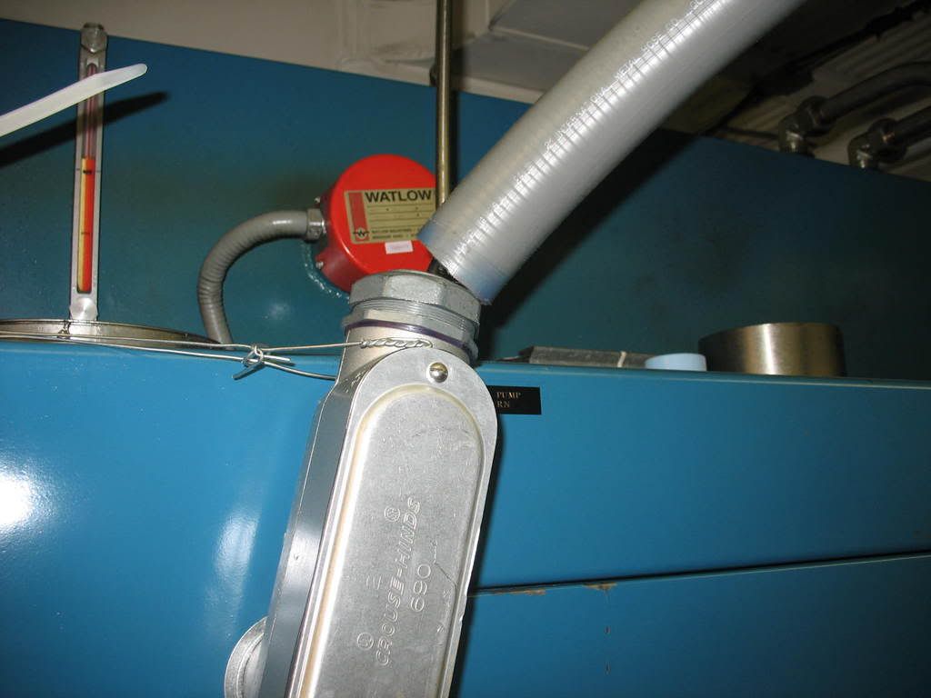

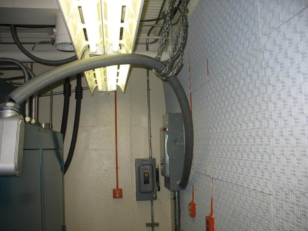

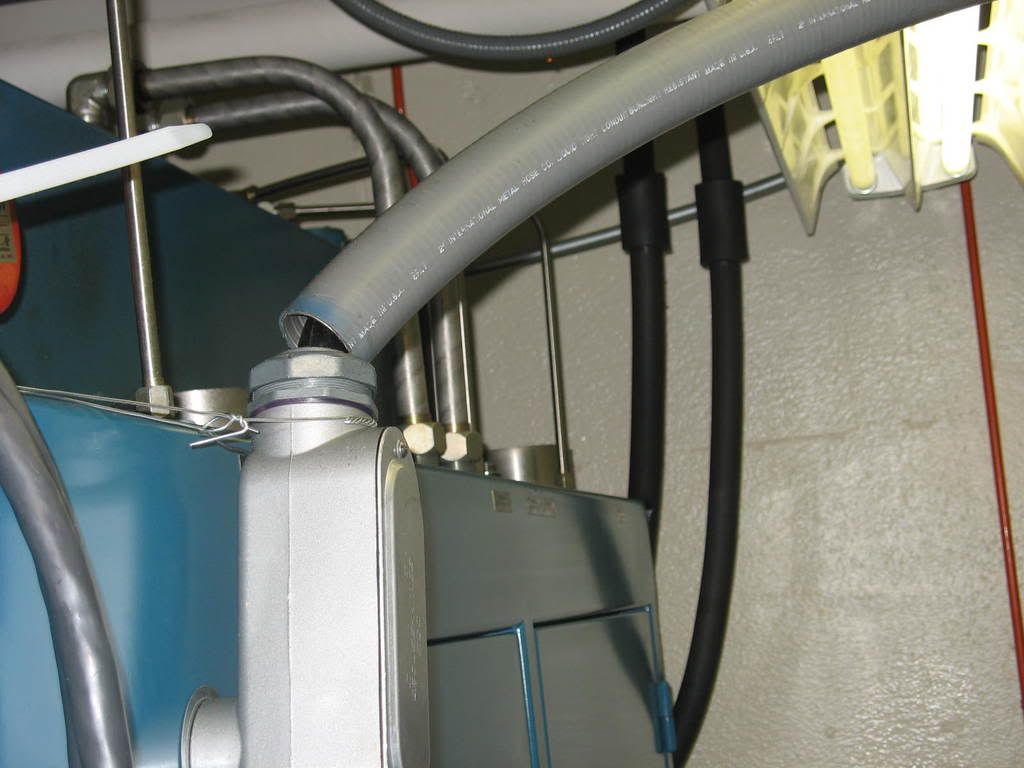

Please look at the following pictures. This sealtite goes from a disconnect to a test stand used for testing filters. The stand is on wheels and is rolled back and forth a few feet from time to time. I would like to change the sealtite to a rubber cord, but I am not sure if the NEC permits it in this case. The sealtite gets pulled out of it's fittings everytime the stand is moved. It is fed by 200A 480V 3 phase. In my mind the rubber cord would be safer than exposed THHN. Any comments or ideas??
