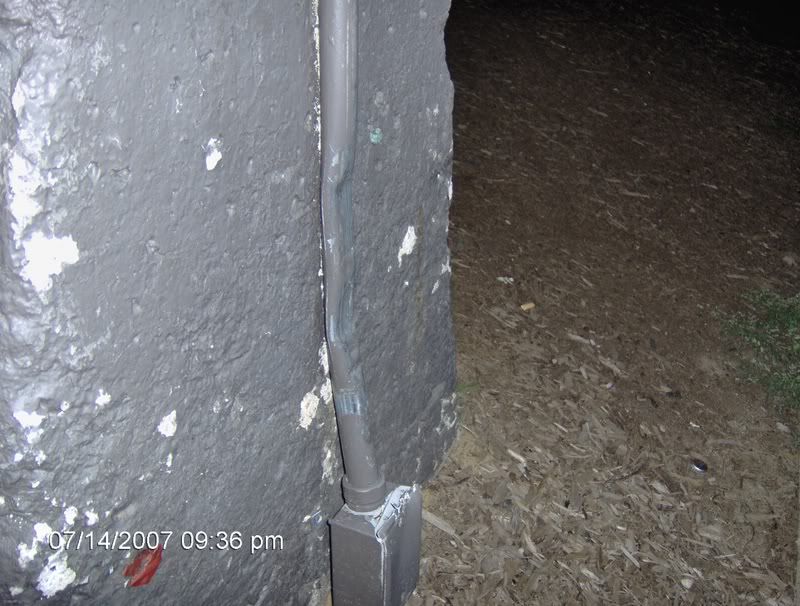

I thought you'll might get a kick out of this, I assume that the
house maintenance guy had his hand in this, but I can only assume.
Plus, I'm testing how to post pic's here ...
I resized it down but the "tagged" area didn't seem to work.
or I couldn't follow the site instructions, to grab that edited pic.
480sparky
Iowegia
My old peepers aren't good enough any more to tell much, but it looks like liquidtight that is unsupported, and maybe a straight connector on the pole instead of a 90?? I also cannot tell if it's connected to the handhole cover or not.
cadpoint
Durham, NC
Right, Liguid Tight is not supported, that is a straight connection, and I walked over to find no hand-hole.

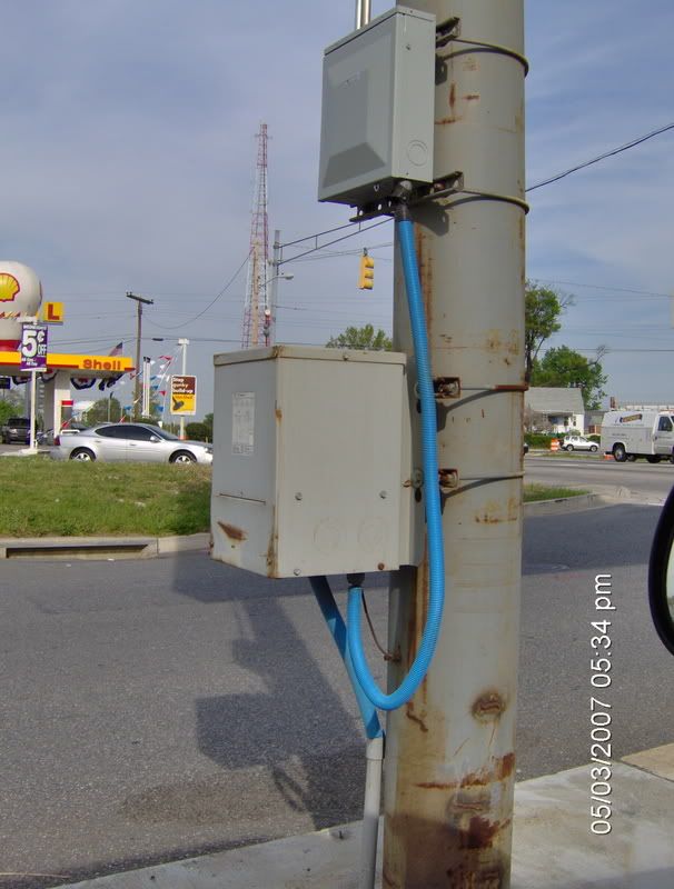

GC called me yesterday said he has a pallet full of random (longer) lengths of that blue liquid tight, asking if i wanted them. Of course i said yes:grin:
I have a 6' piece of it that's been sitting in my garage for the past year. Do you want it? ;)

John, I guess I didn't give enough info , and not that I have it in this case either, the pole was above 16' (best guess).
The hand hole was used for the penetration of the flex, sorry I didn't get a close up of that!!! Not that its listed for a water tight cover to be penetrated? ! I don't know if that is a violation? Like materials come to mind, but I can?t recall the connecter of the flex! Duh
I just won't have done it this way, and I believe most won't either.
A box in the ground, (while optional) might have added in this situation other lightpoles did have a pull box below pole base in various status of decay, I do remember looking at others...
Straping and a 90? "L" would have made it all "tighter" ...
Most bases aren't level enough and aren't finished to any extent when the pole is attached, most app's around here design in some separation off the base to apply grout in this cavity and was applied here.
