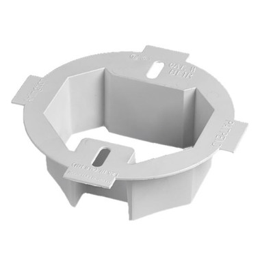

5/8" drywalls when I set all my boxes for 1/2"

They may make extenders for round boxes, but I've never seen one.
