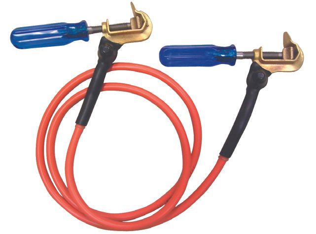

I'm sure a similar tool is available in the US, but my google fu finds hardware from Australia:

As I stated above, an open neutral situation can only be confirmed by taking measurements in the main service, requiring the services of an electrician.
Measuring current on the pipe you are cutting will give you a good idea of if there is a problem present, but cannot give a guaranteed result because as noted a low current might be the result of low neutral load.
IMHO what you should do as a plumber is to have a good set of bonding jumpers which you use to bypass any section of metallic service pipe which you may be cutting, and use those bonding jumpers religiously. Use something which can't be knocked off by accident.
Also, if you measure high current (several amps) on a pipe that you are about to cut, you might request the customer bring in an electrician.
Thanks for the response. Yes you did say that. Do you think car battery jumper cables would work for this? Also if I were to replace a section of metallic piping with pex and then remove the jumper would I be causing a problem?
Yes you did say that. Thanks for the response. Do you think car battery jumper cables would work for this? Also if I were to replace existing metal piping with pex and remove the temporary jumper cable, when would I be causing a problem?

Some jumper cables save money by using weak springs which may not lower the contact resistance enough for the 200ADC they might pass.
I'd use a lightly sanded pipe with the wire under hose clamps.

I personally would not trust battery jumper cables; too much risk of then being knocked off.
If there is a problem, and you were to jump a chunk of metal piping, cut that pipe out and replace with plastic, and then remove the jumper, the problem would become apparent as you remove the jumper.
This comes down to your familiarity with the plumbing installs in a given area. A connection to soil will never carry enough current to be an issue. The issue is common metal piping systems. So if you know that the water main in an area is plastic, then even if the pipe into a building is metal you know that replacing a segment won't be an issue. But in a region with common metal supply piping, you can't really know if there is a problem when you break the piping circuit.

You can keep something like THIS on your truck to bridge the pipe when you have to cut it.

I am surprised that no one in the US makes something similar to the tool I posted in #21.
When I search for 'temporary bonding jumpers' I get links to tools that lineworkers use to jump lines that are grounded for work, not something for plumbers to use.
Bro8898: perhaps you can take the link in post #21 to one of your supply houses to see if they sell anything similar.

Wow that’s good information. I’ll be sure to purchase a jumper like the one you posted and not one made for a car battery. I’m sure I can find it somewhere.
So if a pipe is in the ground and both sides are buried in the dirt, then I don’t really have a risk of getting shocked? But will it still break the neutral path and damage equipment?
If you do find a US supplier, please post a link here.
